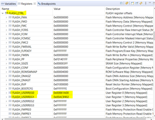

I need help in unlocking the MAC address to restore it to factory settings.
I followed the sequence in the document spma075.pdf by using the command  since I'm using the XDS200 programmer and following the subsequent instructions of holding and releasing the reset button but I'm unable to unlock the MAC address.
Could you please help in finding what I could be missing?
