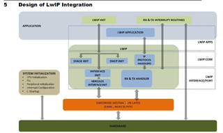

  • I have a question, why is the emac library created by halcogen not used, but the features from this library are rewritten in hkdif ?
  • Hi Fatih,
    If you verify the LwIP design and its layers
    The application will not use the EMAC functions directly, and the EMAC will interface with the LwIP interface unit. That is the reason the EMAC functions are used in hdkif (Hardware Development Kit Interface) module.
    Thanks & regards,
    Jagadish.
    Thank you for the diagram, I realized that it was not working due to the queue structure I used and I solved the problem.
    I managed to run lwip with freertos but now I encountered the following problem. Do you have any ideas on how to solve this problem?
