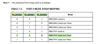

I was able to read the PHY CHIP DEVICE ID Correctly, PHY ALIVE STATUS, PHY LINK STATUS. But when i transmit the data it was not transmitting.
I think I have made fault in making a RMII CODE, I have configured RMII in PINMAX TAB, enabled RMII .In SPECIAL PINMAX TAB Selected RMII . And disabled ENABLE MII IN EMAC TAB. Is there any other changes i have to made to work with the RMII mode.

We are using LAUNCHXL2-RM57L development board and EVB-LAN9354-RMII development board for LAN9354 PHY CHIP. I have connected the RMII,MDIO PINS in the LAUNCHXL2-RM57L to the respective pins on the EVB-LAN9354-RMII . To disconnect the DP83640 IC  on the launchpad I have removed the R8 and R9 resistors on the launchpad.
Here also I was able to read the PHY CHIP DEVICE ID Correctly, PHY ALIVE STATUS, PHY LINK STATUS. But when i transmit the data it was not transmitting.
