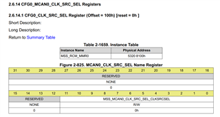

Hi Ming,
Can they change MCAN clk source via syscfg?
Mari Tsunoda
Hi Ming,
As shown in 4.19 MCAN Integration chapter in the TRM, shouldn't they be able to select one of the clk sources via mux?
Mari Tsunoda

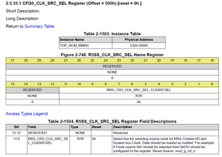

Hi Mari,
Yes. You can change the clock source with the following register, but you cannot do it in syscfg:
In the example mcan_loopback_interrupt_am263x-cc_r5fss0-0_freertos_ti-arm-clang, the MCAN1 clock source is set to 80Mhz using SOC_RcmPeripheralClockSource_DPLL_CORE_HSDIV0_CLKOUT0 as the clock source by SOC_moduleSetClockFrequency() in Module_clockSetFrequency() of ti_power_clock_config.c (a syscfg generated file). It is fixed though.
Ming
