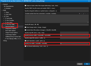

  • Hi Alex,
    Can you try setting the --memwidth and --romwidth options to 8 in the project settings?
    To do this right click on your project and go to properties, then expand Arm Hex Utility, and update these under General Options.
    I would expect these to be set by default on examples where we have the arm hex utility enabled by default, but it may have been missed on these examples.

  • Hi Brandon,
    Thanks for the suggestion.
    It looks like the Arm Hex Utility was disabled in the bsl_host_mcu_spi example by default, and enabling it with mem and rom width 8 and rebuilding seems not to have fixed the problem.
