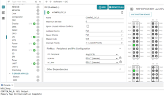

    The following is my configuration
    //// _________________________________________
    I2C on SysConfig
    UART in SysConfig
    Display
