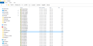

We don't have SVD file for Hercules devices (that includes TMS570LC4357).
We have only XML files for these devices. You can find them in below path of CCS.
In above thread they pointed out one software and mentioned that using this software we can convert XML file to the SVD file. I never tested this in practical, but you can give a try.
