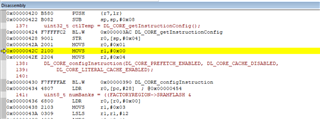

I single-stepped the code in keil software and added writeStr to Watch. I can see that the address is 0x200000D4.
Check the data stored at the address 0x200000D4 in Memory. You can see that there are three bytes of data. This is the value I entered through the keyboard peripheral.
When the program enters GROUP1_IRQHandler, after running DL_FlashCTL_unprotectSector(FLASHCTL, MAIN_BASE_ADDRESS, DL_FLASHCTL_REGION_SELECT_MAIN);
You will find that the data stored at 0x200000D4 in Memory has been modified.
When the breakpoint is triggered when the writeStr value is modified, you can see that the above Disassembly window code stops in the picture below. At this time, you can observe that the corresponding value has also changed in Memory.
The above is the phenomenon I found during debugging. I hope someone can give me some advice.

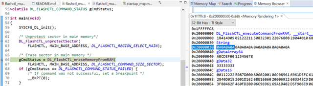

    I tested on CCS v12.5. And I do not see this issue on my side. The String value is not changed.
    This issue looks more like a compiler issue to me. What is the compiler version customer is testing on? And can the provide their code? Or they can try their code on CCS v12.5 or v12.6 for test.

    Thank you for your reply!  I am using keil 5.39 + mspm0_sdk_1_20_01_06, and I will upload the project files. It seems that when you tested, you put DL_FlashCTL_unprotectSector in the main function for execution. This is no problem for me. Putting it in the main function does not have the problems I mentioned. My problem is mainly that after responding to an interrupt, operating the flash in the interrupt function may overwrite the original value of the global variable. Many of us here have encountered this bug, and there is no root solution. Because we don’t know exactly where the problem lies.
