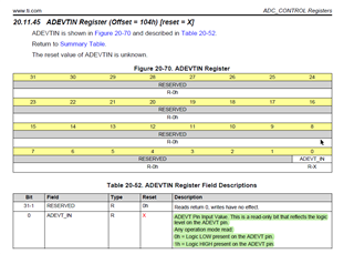

    You can do one more thing also, that is you can just monitor the status of the ADEVT_IN bit in the ADEVTIN register because this bit reflects the status of the AD1EVT pin. So, for example, if you configured to trigger this pin to trigger ADC conversion on raising edge then you can monitor this register to find out whether the 0 to 1 transaction happens or not.
