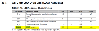

Why the datasheet current consumption table and LDO table 27-63 does not show a formula (Iinrush) though table 27-8 shows LDO ranges 50mA - 150mA? Do we assume LDO Iirush depends on how many peripherals are enabled after POR? It's not a launch pad sporting 500mA LDO though seem to recall runtime current being roughly 78mA steady state. Was there ever Tina model made for TM4C1294?
Table shows all peripherals off (65.3mA 105°C) so we have to also add LDO inrush to that? Also does not account for 3v3 rail capacitors and any bulk caps in the circuit though large capacitance on 3v3 rail slows down the rate of total inrush via external LDO.

  • Hi BP101,
     What exactly are you looking for? Inrush current is showed below.
    Hope this FAQ is useful for inrush current explanation. https://e2e.ti.com/support/power-management-group/power-management/f/power-management-forum/1127642/faq-inrush-current-from-an-ldo-perspective

    As explained above does that include CPU, NVIC, peripheral current too? So 250mA seems a bit excessive for CMOS LDO has anyone TI actually confirmed that in LAB analysis other than datasheet table? What about Tina model?
    FYI: Table 27-15 does not show actual LDO run time current as the FAQ relates to a known inrush current level and time period graph.
  • I'm not an LDO expert. My understanding is that the Inrush current occurs during the time when the LDO regulator turns on to the time when the output voltage stabilizes. The LDO drives the output transistor between the input and output with the maximum drive capability to raise the output voltage to the programmed level. I don't think it includes the CPU, NVIC and peripheral current during this time yet. Until the VDDC is stabilized, the circuits that depend on the 1.2V are still held by the internal reset.
    We don't have Tina model for TM4C.
