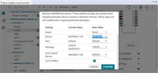

    I migrated the example code of BQ76952 from L1306 to C1104 TSSOP package.
    I changed the original input pin from PA14 to PA16, since the C1104 TSSOP package does not have PA14 pin.
    And copy the ti_msp_dl_config.c and ti_msp_dl_config.h to an empty_non_sysconfig project. The project build without errors. You can try with it.
