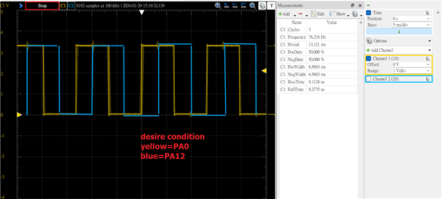

Hi sir
i use MSPM0G3507 EVM board to design my application.
PA0  use for zero event toggle, every 6.5535ms
PA12  use for timer compare match auto toggle, every 6.5535ms

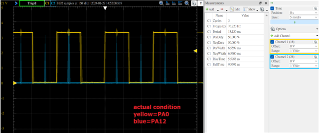

PA0 is ok, no problem but PA12 doesn't work

please help me to to resolve why PA12 can't auto toggle, thanks

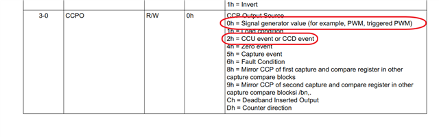

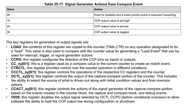

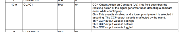

    Please try with DL_Timer_setCaptureCompareOutCtl(TIMG0, 0, 0, 0, DL_TIMER_CC_0_INDEX);
    Cash Hao
  • Hi Cash
    thanks for your help, it's down.
    can i ask why is CCPO set to 0 instead of 2?
    For my understanding, when setting CCP0 as 2, the output only action at exact compare value = counter condition. When the counter value passing the compare value, it will trigger the action again. The pin out will back to zero then,
    #define  DL_TIMER_CC_OCTL_SRC_CMPVAL   (GPTIMER_OCTL_01_CCPO_CMPVAL)
      Output controlled by compare value = counter condition.
