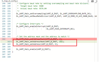

    I use the SDK 1.20.01.06, did you try the extend mode ? It seams that the setAdress and setMask are not avalable in main mode.
  • And in normal mode, the setMask and setAdress function is not included in our driverlib,which means you cannot call this function. That is why I want to ask you the version of Sysconfig and SDK, as you can configure it normally and experiment with it.
    If you suffer from this problem, please exclude the Sysconfig, and then try to modify the register value directly
  • I mean this two function is not included in driverlib, so we can not call this function
  • If you active extend configuration it will work, the two functions are included in dl_uart_extend.h . But yes, I guess It's a problem.
  • Thanks, and I will feedback this problem to our software team.
