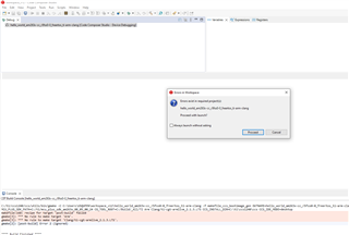

I got simular issue, I imported the empty example project from the SDK and tried to load it onto AM263x_cc emulator board.
I was loading the program from Debug as ->CCS project session.

  • I did follow the above instruction to setup the develop environment. This is the second around that I re-install everything. still the same issue.
  • Please double check, your screenshot shows you are on MCU SDK 8.5.xx.  You need to be on the latest version of the SDK: 09.01.00.41
  • Our team start with version 8.5.xxx, we haven't roll into the latest yet. I could upgrade to the latest alone.
  • I would also suggest using the latest version of CCS.  Please update to the latest versions of both SW and try again.
  • OK, I fixed the load build issue by changing the TLS search path to exact where I installed the CCS, the load build issue is gone. But I still got the same error when try to load the program

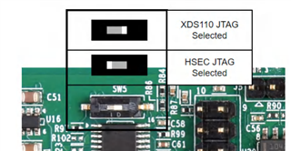

  • Is SW5 on the EVM in the 'ON' position? XDS110 JTAG Selected
  • Yes, the SW5 is set properly. Here is my target connection test log. It looks match with the log you posted above:

  • Is this message normal?
    "Selected device does not currently provide project initialization details for the TICLANG toolchain. The project may require further manual set up."
  • What device do you have selected in the Target Configuration?  It should be AM263x_CC
  • Yes, it is AM263x_CC, I even set the JTAG TCLK to 1MHz:

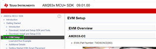

  • Please follow this more detailed guide to ensure you have not missed any steps: https://dev.ti.com/tirex/explore/node?node=A__AD2nw6Uu4txAz2eqZdShBg__com.ti.MCU_PLUS_SDK_AM263X__aBmeCqF__LATEST
    Please also check the EVM Setup page to ensure all connections and switches are configured correctly:
    Brennan
