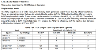

In SPRUJ17C – MARCH 2022 – REVISED NOVEMBER 2022 - TRM, It mention about some operating modes in Single ended mode operation of ADC like, default, shifted and scaled.
as below
But it is removed from latest TRM.
Could you please confirm whether these modes are applicable in latest microcontroller? Or
Are we able to use only default mode?
