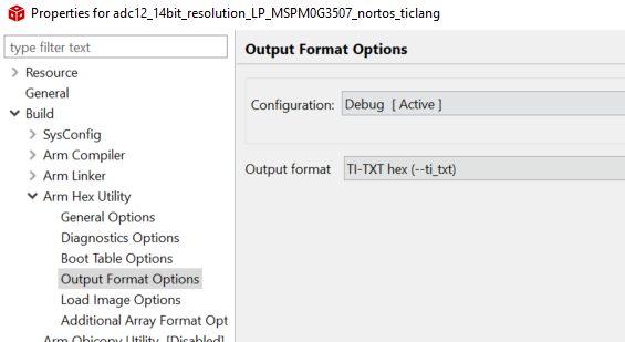

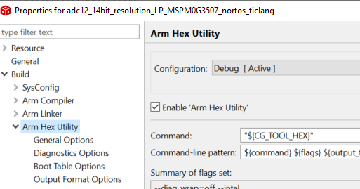

First enable "Arm Hex Utility".
Then choose the output format in "Output format options"
You can use uniflash tool to program the device as well. https://www.ti.com/tool/UNIFLASH
