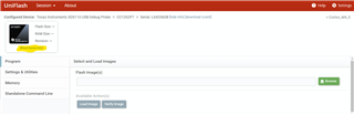

Whenever I try and use Uniflash I get the error in the image. This happens regardless of whether its the online or Windows version.
Its not the debugger or connection. Using CodeComposer Studio I can download connect to my board and chip (CC1312R7) over the debugger without any issue. I even updated the firmware on the debugger (XDS110).
Error: 0x00007858 115 3 LIB C: dlopen( "MiniDump.dll", 0 ) 0x00007858 115 3 LIB R: dlopen( "MiniDump.dll", 0 )   OR
0x00002C08 532 3 LIB C: dlopen( "MiniDump.dll", 0 ) 0x00002C08 532 3 LIB R: dlopen( "MiniDump.dll", 0 ) = 00007FFE04B30000
I have reinstalled Uniflash 8.3 multiple times. Any ideas?

  • Hi Sid,
    Uniflash 8.5 has the same problem (I just tried it). I get the issue by pressing the "Read Device Info" button after the programmer is detected but before it has tried to communcate to the board. Pressing the "Load Image" button with a valid image of your choice produces the same result.
  • Hi Lucas,
    Your screenshots, seem to differ with the device, did you try both CC1352P7 and CC1312R7?
    I tried Uniflash 8.5 and was able to read infor from both CC1352P7 and CC1312R7. I will reach out to the Uniflash team.
    Sid
  • Hi Sid, Good eye. When using using auto-detect, it pulls up the CC1352P7. However, I can manually select the CC1312R7. I get the same issue regardless of which chip Uniflash targets. Even using the LP-CC1312R7

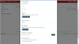

  • Can you generate a Debug Server log and attach it to this thread?
    See section called "Defect Reporting and Logging": https://software-dl.ti.com/ccs/esd/uniflash/docs/v8_5/uniflash_quick_start_guide.html#defect-reporting-and-logging
    Can you also provide the host OS (and version) being used?
    ki
  • Hi Ki,
    Windows 11 Pro 10.0.22621 Build 22621.
    I was able to do the GUI debug (attached). The DS Server debug shows the "Enable" button whenever I open Settings. When I click on it the button changes to "Disable" but it does not show a path to the ds.log file (as in https://software-dl.ti.com/ccs/esd/uniflash/docs/v8_5/uniflash_quick_start_guide.html#defect-reporting-and-logging). Closing and re-opening the Settings window has the DS Server debug logging disabled again. I tried running in admin mode and looking on the file system for a ds.log file but to no avail.

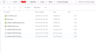

  • The DS Server debug shows the "Enable" button whenever I open Settings. When I click on it the button changes to "Disable" but it does not show a path to the ds.log file
    That's really odd. When I press "Enable", I get the full path like:
    I am using Windows 10. I'll try to see if this works on Windows 11.
  • Huh. I do not get that path when pressing Enable. I can go to that that path. It has some config files in there, but no ds.log files. One of the log files attached for reference. They're very dull.

  • Can try a different way to generate the log:
    Go to the section "Diagnostic Server Logs -> Command Line") in the below article and follow the steps to enable DS logging from a DOS console:
    https://software-dl.ti.com/ccs/esd/documents/ccs_diagnostic-logs.html#command-line
    Then from the same console, launch Uniflash via:
    > C:\ti\uniflash_8.5.0\node-webkit\nw.exe "C:\ti\uniflash_8.5.0"
    If you installed UniFlash 8.5 in a custom location then update the above accordingly.

  • Okay, I think I fixed the issue. At some point I had set a windows envionment variables below. It must have been what was messing with the uniflash instance. Uniflash now works just fine.
    TI_DS_ENABLE_LOGGING=true
    TI_DS_LOGGING_OUTPUT=c:/temp
  • At some point I had set a windows envionment variables below.
    Interesting. Did you set those in the past to troubleshoot something else in the past?
    In any case I'm glad you found the root of the issue. Thanks for the update!
  • I did run into issues with it previously, but CCS was working and it was a lower priority issue so after some failed debugging I moved on.
  • After some investigation, it appears that the issue is that TI_DS_LOGGING_OUTPUT was set to a directory that already exists without an additional file name. The apparently causes some issue with TI Cloud Agent which was impacting UniFlash.
    I filed a bug for this. Tracking link: https://sir.ext.ti.com/jira/browse/EXT_EP-11635
