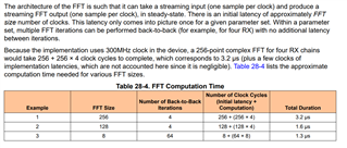

    1. Is there any benchmark FFT using Hardware Accelerator 2.0?
      1. Please find the attached image.

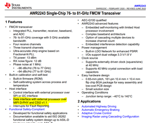

    3. I think EVM is receive mmWave Raw data through LVDS or CSI, could we receive through SPI interface?
      1. Please find the data sheet that specifices all available data interfaces on the AWR2243.
    Where could we find this table? in Technical Reference Manual?
    I think AM2732 DSP system operate in 450MHz but I think your picture is in 300MHz.

  • Hi GR,
    Please find my responses below:
    1. It can be found in the TRM Section 6.4.5.1.5 Core Computational Unit – FFT Quantization and Speed Performance. You are also right; the HWA clock speed is 400MHz and not 300MHz or 450 MHz as shown in the diagram on the AM273x device. The screenshot was for the HWA 2.0 that was adapted in another device and the clock was different but as far as the cycles are concerned, it would take the same in both cases. Apologize for any confusion.
