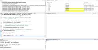

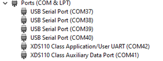

I am asking this question for a Mass-Market customer. We run the enet_l2_cpsw demo under DEV BOOT mode, already use load_dmsc_hsfs file to do the SOC initialization before downloading the project. But we still don't see any thing prompt in UART terminal of CCS when running the demo. Already checked the terminal number, it is ok.
Maybe it is not related to the enet_l2_cpsw, because I use an empty project and just output debugp log (UART log enabled) but still no any contents in UART terminal. However AM263x-CC doesn't have this issue. Can you give some advices?
