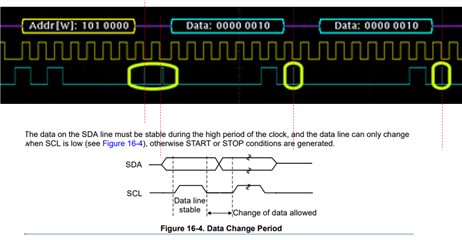

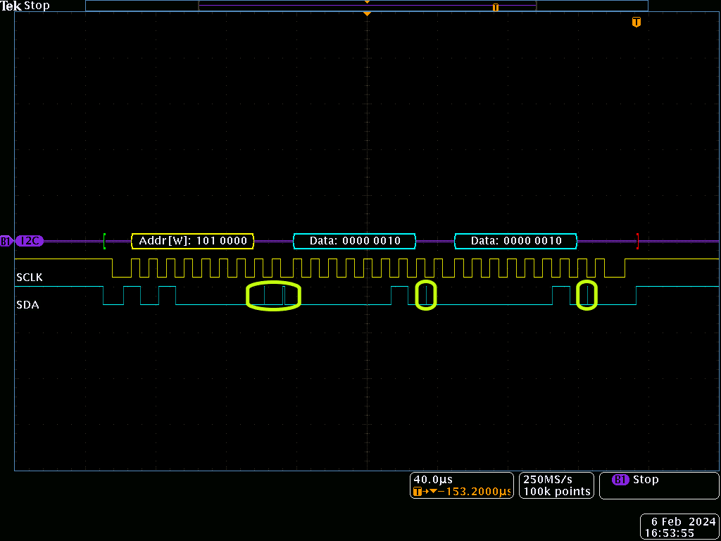

I'm wondering if this effect applies to the general I2C bus, I am using the MSPM0L1306 and a similar issue is happening
Is this behavior normal? Is there a way to fix it?

There is nothing you can do to remedy this spikes.
Referring back to the earlier posting, Brent is correct. If you look closely at your timing diagram, you will notice the spikes occur only on the "falling" edge of the SCL. According to the I2C specification, the SDA must be stable just before (ns) the rise of the SCL, and must remain stable until the falling edge. Since these spikes occur after the SCL falling edge, devices that are I2C compliant should not be affected by them. With your logic probe, try zooming in as far as possible and measure the time from the SCL falling edge to the spike. What do you measure?

I made the measure and the delta time from fall to rise is ~50.3220ųs
Let me know if more details are needed.

Ok, so you are saying the time from SCL falling to SDA rising is ~50us, correct? If this is true then there is nothing to be concerned about.
