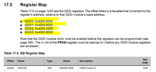

    I am aware of the availability of APIs and how they operate. However, when I examined the API code, I discovered that the register address differed significantly from the datasheet's direct register address.
    How can I use DRM (direct register manipulation) to send and receive data and configure SPI (SSI)? What are the specific steps in the process?
    Thanks & Regards,
    Vijay
  • The base addresses for QSSI modules are listed in the datasheet.  You need to use these registers. They are matching the hw_memmap.h file.
