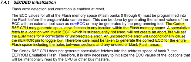

  • ESM 2.3 indicates incorrect ECC values in Flash.
    The ECC values for all of the Flash memory space (Flash banks 0 through 6) must be programmed into the Flash before the program/data can be read. This can be done using linker cmd file.
    https://software-dl.ti.com/hercules/hercules_docs/latest/hercules/How_to_Guides/HowToGuides.html
    The bank 7 is a data flash. Did you program your code to bank 7?

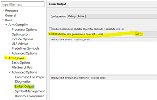

  • Here is an example if linker file to generate ECC for the whole flash:
    https://e2e.ti.com/cfs-file/__key/communityserver-discussions-components-files/908/2330.sys_5F00_link.cmd
  • 1. To enable the ECC generation using Linker CMD file, CCS->project property-->ARM Linker -->Linker output
       When Linker ECC generation is used, the "Auto ECC Generation" during program load should be unchecked: CCS->tools->On-Chip Flash->...
    2. Add palign(0) to the SECTION of the Linker CMD file:
    Since the ECC on all TMS570 devices is calculated on a 64 bit or 8 byte boundary all data and code sections which are placed in the on-chip flash should also be aligned to a 64 bit boundary. They furthermore should also end at 64 bit boundaries to ensure that the complete section will have a length of a multiple of 64 bits and is entirely be initialized. The easiest way to achieve this to use palign(8) on all output sections in the Linker Command File which will be placed in the on-chip flash.
    Flash bank of tms570ls3137 mcu contaion 0xff value when sector is ereased and empty but tms570lc4357 mcu containt different value.
    Because it has invalid ECC value, the ECC mechanism tries to correct the flash data using the invalid the ECC value.
    It seems CCS generates ECC value only using flash area.
    The "Auto ECC generation" during program loading only calculates ECC value of the application image.

    Does speculative fetch operation cause all of this problem?
    Additionally, when I close the flash region that is not used by the program code with the MPU (No Access attribute), there is no error received from ESM 2.3. If this problem releated with speculative instruction fetch operation, It seems speculative fetch operation uses random flash memory address. In this case, CPU doesn't fetch this memory area exactly because of MPU and abort signal doesn't generated because this operation is discarded. Is that true?

    I understood that the ECC error is caused by a speculative fetch. To prevent speculative fetch error the ECC value of the whole flash (both banks) should be programmed once.
    The speculative fetch will generate an un-correctable ECC error.
    If the compiler generates a compare against a register contents, and then the next instruction is an LDREQ Rd,[Rs] (conditional load). The CPU starts the memory access based on the contents of Rs, before it evaluates the results of the compare. If the compare is not equal, Rs may have some random value. The CPU discards the memory contents it read (not put into Rd) and does not do an abort. But the memory read generated the CPU event signal that tells the ESM there was an uncorrectable flash error.
  • In this situation, if I set MPU as no access to unused flash region, CPU can't fetch any instruction from unused flash region. Normally, CPU generates an abort but there isn't an error because of discarding this operation. Also ESM 2.3 error doesn't recieve because CPU couldn't access even it is speculative access to random flash memory content.
