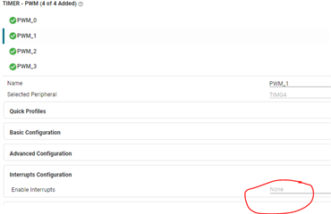

then i used system configuration to add TIMG4.
i encountered one issue, i coundn't select the TIMER.
in order to use TIMG4, i enabled all TIMERs of L1306, so would you please kindly let me know how to assign peripheral(for example just use TIMG4 only) in the system configuration?
From the following code, i learnt the TIMG4 was assigned to PWM_1_INST.

so i added the Initialization code for TIMG4 in MAIN.
int main(void) {
  SYSCFG_DL_init();
  NVIC_EnableIRQ(PWM_0_INST_INT_IRQN);
  NVIC_EnableIRQ(PWM_1_INST_INT_IRQN);
  DL_TimerG_startCounter(PWM_0_INST);
  DL_TimerG_startCounter(PWM_1_INST);
  while (1) {
    __WFI();
and added the TIMG4 IRQHandler.

 the code is compiled OK, and i begun to debug this code on LP-MSPM0L1306.
Unfortunately, the interrupt of TIMG4 was not invoked.
the code will not run into  'void PWM_1_INST_IRQHandler(void).'
would you please kindly help check how to make the code work for TIMG4?
