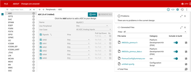

I don't think this issue is resolved. I don't see any csv files generated.
Is there a clean way to share my pin assignments assigned in SysConfig?

Unfortunately this is specific to an SDK. Based on prior posts I believe you are using AM263. I will direct this to the AM263 team to comment.
If you run SysConfig in pure pinmux mode it does generate a summary csv for AM263 today but if you are using the SDK it does not.
