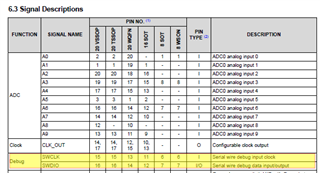

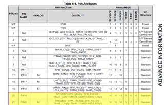

my colleague and I are currently developing two new appliances using MSPM0C1104 MCU and now found out, that in the datasheet position of SWDIO and SWCLK is sometimes mixed up and we do not know which version is correct one.
On page 7 (Table 6-1. Pin Attributes) it is stated that PA19 -> SWDIO   / PA20 -> SWCLK
Depending on package PA19 (SWDIO) is always located on lower pin-Number (for example Pin 13 on WQFN-20 housing), PA20 (SWCLK) is always n+1 (for example Pin
But in Table 6.3 Signal Descriptions, the SWCLK and SWDIO Pin-Assigment is exchanged:
Could you please help me to clarify, which pinout is correct?
