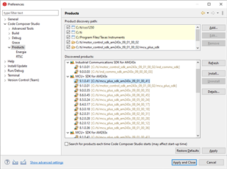

  • Hi Dimitry,
    In your first screen capture, the CCS reported the "Discovered products" has the AM243x MCU+ SDK 09.09.00.41. You have to select it and install it for it to be recognized by CCS. Keep in mind that there is an AM243x MCU+ SDK inside the Motor Control SDK. In order for the CCS to pick it up, you will need to add the C:\ti\motor_control_sdk_am243x_09_00_00_05\mcu_plus_sdk into the "Product discovery path" in CCS.
    Ming
  • Hi Ming,
    Thank you. I have done it, but it did not help.
    Dmitry

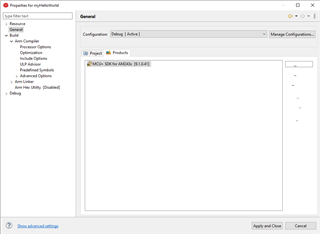

  • Hi Dimitry,
    Here is the screen shot when I used the Project Wizard:
    There only two projects available: empty and hello world, I am not sure it worth any further pursuing. You will be better off to explore the existing CCS projects.
    BTW, you can always add the AM243x MCU+ SDK into the newly created CCS project:
    Here is the screen shot of my CCS 12.5.0 setting:
    Ming

  • Hi Dimitry,
    Indeed, the creating of a new project from the CCS directly is deprecated at least for the AM243x MCU+ SDK, because it does not create syscfg file for you.
    That is why we recommend customers to import/modify instead of creating new ones using the project wizard.
    You should not keep both MCU+ SDK in motor control SDK and the stand alone one active at the same time, because they are the same version. For example: the MCU+ SDK at C:\ti\mcu_plus_sdk_am243x_09_01_00_41 and C:\ti\motor_control_sdk_am243x_09_01_00_06\mcu_plus_sdk are the same AM243x MCU+ SDK 09.09.00.41.
