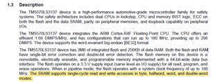

  • Hi jagadish,
    TMS570LS3137 reads and writes data to RAM with MIBSPI5. Can the communicate speed be changed? Is that decided by the Clock (System Clock)?
  • Hi Steve,
    Apologies for the delay in my response.
    Reading / writing to the RAM will not affect the speed of the MIBSPI5 communication.
    Because as you can see the RAM access will be a single cycle only and with max frequency of 180Mhz.
    So, that means to read/write one byte or word from RAM will be happen in the 5.5 nano seconds (1/180Mhz).
    Whereas the maximum SPI communication speed is 40 nano seconds that is 25Mhz.
    So, to transmit one byte of data at this speed will take (8*40ns), that is 320ns. So, to transmit or receive one byte over MibSPI will take 320nS whereas to read / write from RAM will only take 5.5nS. It is very negligible time as compared with MibSPI speed.
    So that means RAM read/write will not affect the MibSPI speed.
