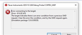

I am getting this error on my launchpad:
For the MSP432 LP, there was a procedure to reset it to factory settings. (I tried this in CCS, but there were no scripts) Is there a similar procedure for the MSPM0?
Hi, Keith
I didn't find target configuration view in CCS-Theia.
MSPM0_Factory_Reset_Tool (ti.com)
You can use this online tool.
Helic
There is a way to do it in Theia:
Section 3.4 - Though I have not needed to try it yet.
Hi, Keith
Thank you for your feedback.
There is naming difference between CCS and Theia.
Sorry for my miss.
Code Composer Studio Theia IDE Version 1.2.0+ for MSPM0 MCUs — DSSM Commands
Thank you~
