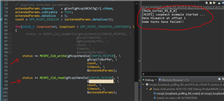

My customer is looking for separated API for MCSPI LLD (use read and write instead of readWrite). They have tried mcspi_lld_read() and mcspi_lld_write() in the mcspi_loopback_polling_lld example but gets incorrect data.

  • Hello Hang,
    I found out the root cause here.
    I tried the approach where I used separate write and read APIs of MCSPI LLD in Polled Mode of operation.
    I was using the classic MCSPI Loopback example which is provided in the SDK itself.
    What I have noticed is that after the Write API is called and is finished, the actual MCSPI TX and RX Registers are filled up with correct values.
    Please notice the below attached image.
    The above registers are populated even before the read API is called.
    Now when the read API is executed and I debugged every step, turns out that the MCSPI FIFO Write is being called again, hence, the registers TX and RX both reset to 0, and is deprived of their actual values.
    As of now, I have checked internally and got to know that these APIs basically separate write and read APIs can be used for:
    • Write API: When the MCSPI is set to controller mode of operation
    • Read API: When the MCSPI is set to Peripheral mode of operation.
    • readWrite API: To demonstrate the loopback capability.
    I hope this explains the problem.
    Thanks for your patience.
    Vaibhav
