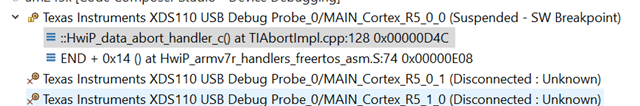

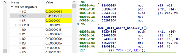

For a better understanding let's look what happens in case of an abort:

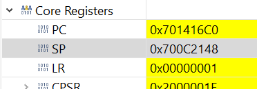

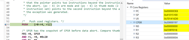

we see in the LR the previous PC (+8) which caused the abort. That's good.

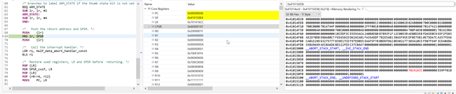

Then the corrected LR gets pushed onto the stack (see the memory view right hand):
as soon as the new HwiP_data_abort_handler_c is entered the LR is messed up:
also the stackframe is:

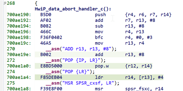

and check the SP. As soon as I step above the entry point of the function it progresses 16 bytes instead of my suggested 8 Bytes:

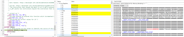

I now wanted to add the previous sugested solution but this does not work since of course the LR is not there to be popped. it's 16 Bytes away. That's because of the 00000d28:   E24DD008            sub        r13, r13, #8 instruction which I don't understand to be honest.
well it's not a problem to take that into account and to correct this value afterwards.
then it will look like this:
as you can see the LR is now correct. but unfortunately the stack-frame is not fixed again, it stays in the old view:
How can I force CCS to show the correct stack-frame again?

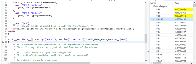

2. I want to store the occuring PC and SP
Well now we can at least get the PC/LR correctly. but what about the SP? In my example the SP before the abort would be:
as soon as the abort happens the SP is overwritten of course. But it is still available in the User-register:
How can I access the user register and retrieve the value from there? Unfortunately I am no arm-developer and I guess I can switch the mode to user mode and get it somehow but the documentation out there is not really helping and links to the arm-documentation are not reliable since it changes like every some years.

    void __attribute__((interrupt("ABORT"), section(".text.hwi"))) HwiP_data_abort_handler_c(void)
        /* correct sp */
        __asm("ADD r13, r13, #8");
        /* two pops because we entered this function which incremented the stack */
        __asm("POP {IP, LR}");
        /* retrieving the correct values for LR */
        __asm("POP {LR}");
        __asm("MSR SPSR_cxsf, LR");
        __asm("POP {LR}");
        __asm("POP {r0-r4, r12}");
    #ifndef NDEBUG
        /* in debug builds we will break to identify the source of the abort */
        volatile uint32_t loop = 1;
        while(loop)
    #endif
    just copy that in and you should be able to reproduce. Maybe set an breakpoint directly at the start of HwiP_data_abort_handler_c for better debugging because I am not sure about the NDEBUG-define. We have it in our project but I am not sure about the TI-examples. An please note that we are utilizing TCMA and TCMB for all interrupt-handlers, not the internal SRAM. so the addresses may look different.
    Edit: I noticed that the example does not work the same way our project does. Here it seems I need to increment the sp for the abort-stack two times more than in our project to get back the correct LR since the dissassembly pushes two more registers onto the stack:
    That makes things more complicated.
    Well we just want to achieve to get back the correct LR at least and at best the correct SP from exactly that line of code which produces the abort.
    It worked well with the previous SDK-versions but as soon as TI introduced the abort-handler with the "_c" at the end, we started to get problems. If there is no reliable solution we may switch back to the old handling, and remove the code from the abort-handler assembly-file.
    best regards
    Felix
        extern size_t __ABORT_STACK_END;
        size_t src = (size_t)&__ABORT_STACK_END;
        __asm("MOV r13, %0\n\t"
                : "r" (src));
        /* correct sp */
        __asm("SUB r13, r13, #32");
        __asm("POP {LR}");
        __asm("POP {LR}");
    #ifndef NDEBUG
        while(loop)
    #endif
    With that you should be able to reproduce the problem I have. As you can see when you step through until line 280 the LR is loaded correctly. Somehow afterwards the volatile loop-variable corrupts the LR again... so no clue how to make this reliable for correcting the LR to the last PC where the problem occured, nor how to correct the stackframe in CCS.
  • unfortunately since there is still no answer I tried to proceed.
    At least my 2. case is not needed anymore.
    But I will still need a way to fix the wrong display of the CCS-stackframe. I need to see where we came from when I am debugging and not the previous address of the asm-abort-handler. In my understanding and further investigating this seems to be a CCS-issue and not an issue of the Registers of the AM243x, since now I have the correct LR but it is just ingoring it. So I guess it's part of a mini-trace or smth like that in CCS which is not possible to realign to the source of the abort.
    How can I fix this?
  • Since I got no answer I continued reverse engineering the problem.
    So I fixed it. It seems that the abort-stack-pointer - 9 contains the value that is used by CCS to show the stackframe correctly.
    A fix could look like this:
        size_t programCounter = 0x00000000;
        size_t spsrReg = 0x00000000;
        volatile size_t* src = (size_t*)&__ABORT_STACK_END;
        /* correct sp */
        src -= 7;
        programCounter = *src;
        src -= 1;
        spsrReg = *src;
        /* fix display in ccs: */
        src -= 1;
        *src = programCounter;
        while(loop)
  • Thanks for all the detail Felix.
