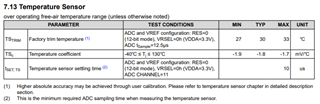

According to the datasheet there is a variance in TStrim and TSc. Does the min and max values of TSc include the variance in TStrim, or do both of then need to be accounted for when determining the accuracy of the temperature sensor.

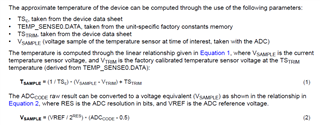

    It is a basic temperature sensor which can be used to approximate the temperature of the device. So I don't think Tsc would include the variance in TStrim.
    You can also refer to the example code, where Tstrim = 30
