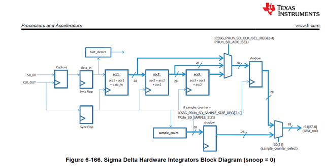

    Over current and fast detection are two different features for error detection, I am sharing details about them which will help you understand the difference between them.
    Fast detect: Each sigma delta channel has a hardware block just for fast over current detection, this block comparatively measures the number of zeros and ones presented in a programmable sliding window of 4 to 32 bits. It starts the comparison after the first 32 sample clocks. Based on the configured zero max/min count limits, it compares zero counter with these limits. If zero counter crosses limit, then it sends an error signal to respective PWM Trip zone block. PWM TZ block receives this error signal and sets trip status bit to bring TZ_OUT pin output state to high.
    This block does zero/one compression with the raw data, I mean whatever input we pass on the SD channel, it reads the data bit by bit and after first 32 bit it starts zero/one compression. So it has very low latency (1.6us @20Mhz SD clock) and is faster than OC.
    see fast detect section here:AM243x Motor Control SDK: SDFM Interface Design (ti.com)
    Over current: It has higher latency than the fast detect block because in over current after executing the SINC3 filter on the sd_in data, the firmware compares the SINC3 filter output with the high and low threshold limits. If the output value exceeds the limit, then the firmware sets the overcurrent error bit of the corresponding PWM trip zone block. The PWM TZ block receives this error signal and sets the trip status bit to bring the TZ_OUT pin output state to HIGH.
    see over current section for more details: AM243x Motor Control SDK: SDFM Interface Design (ti.com)
    and also see this figure for sigma delta hardware:
    Each SD channel only has one associated PWM TZ block, so if you use these features together, the detected error signal may collapse. So it would be better to use one feature!

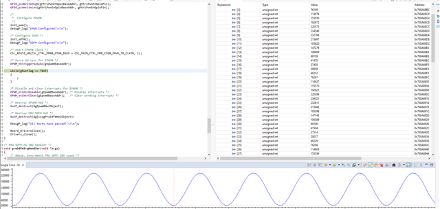

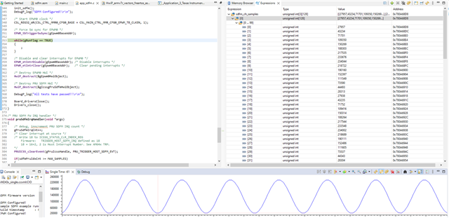

  • Hi Ariel,
    Without clearing the buffers, the sample values ​​will be accurate because we sample three times continuously for a correct NC sample, so what is inside the buffers before starting the NC sample does not affect the final result.
    We did not observe any difference between sample values ​​without clearing buffers and sample values ​​with clearing buffers. I am sharing the sample values ​​here where you can see that the sample data range is almost the same in both cases!
    1. SD samples when buffers are not cleared!
    2. SD samples when buffers are cleared!
    Clarification: IEP reset does not clear accumulator registers and flags, so you have to clear SD buffers manually even for the first sample!

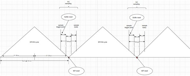

  • Hi Maor,
    To avoid this jitter/noise, I am sharing some methods, you can use any one of them. (OSR64, SD clock 20 MHz)
    • Start NC task one OSR early and wait until the accumulator sample count value reaches 64 OSR
      1. Four times continuous sampling
        1. You have to do continuous sampling 4 times for a correct NC sample, because 3 continuous samples are needed to bring all the registers ​​to stable state and one for precise sample counter value.
        2. Firmware: firmware1.asm file
        3. Limitation: This is adding an extra 3.4us time (one sample) for a correct NC SD sample, so the total time for NC sampling will be 12.8us.
        4. Precise sample counter value: Since SINC3 requires only 3 consecutive samples to bring all the accumulator registers to stable state for a given OSR, but here we are starting NC one OSR early and polling sample counter register with value captured in the previous sample (previous sample counter value + 64). So when we start NC sampling for the first sample, we do not have the exact value of the previous sample counter, so we have to take one extra sample.
          1.  To avoid 4 times continuous sampling, you can use the SINC2 filter, this way you need total 3 consecutive samples, 2 continuous samples to bring the registers to stable state and one additional sample to ensure the sample count value is precise.
          2. You can use the buffer reset approach (solution 2), this ensures that the sample counter value is always zero before starting the first sample.
      2. Buffer reset before each first sample of NC sampling.
        1. You have to clear sample counter register before first sample of NC sampling.
        2. Firmware: Firmware2.asm file
        3. Limitation:  Accumulator registers and flags are common for both NC and OC, so resetting the accumulator will cause problem in OC samples. Because the OC is free run, and we are resetting the accumulator registers and flags in between OC samples.
        4. If you don't need OC then this is a better way.

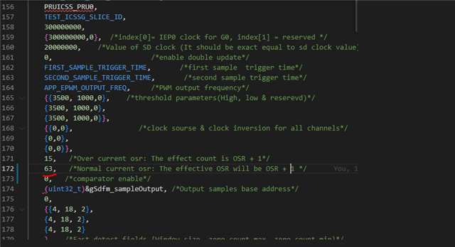

    Application-level changes: Since we are starting the Task 1 OSR early, so you have to pass the NC OSR value 63 instead of 64
