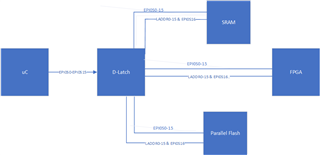

I'm currently designing a microcontroller board with MSP432E401Y which uses EPI Host bus muxed mode for interfacing with 3 devices(SRAM, Parallel Flash and FPGA)
To segregate the address and data line, should i add a D-latch for EPI( Referred https://www.ti.com/tool/TIDM-TM4CFLASHSRAM)
Or the internal ALE pin will capture the address and send accordingly?
Is it fine if i directly connect the EPI pins to the devices as A0-EPI0 and D0-EPI0 ?
Please let me know if there is anything that i have to add in my hardware design

      Please refer to the datasheet for details. Yes, you can use the ALE for the D-latch to hold the address until the data phase.
    11.4.3.1 Control Pins
    The main three strobes are Address Latch Enable (ALE), Write (WRn), and Read (RDn, sometimes
    called OEn). Note that the timings are designed for older logic and so are hold-time versus setup-time
    specific. The polarity of the read and write strobes can be active High or active Low by clearing or
    setting the RDHIGH and WRHIGH bits in the EPI Host-Bus n Configuration (EPIHBnCFGn) register.
    The ALE can be changed to an active-low chip select signal, CSn, through the EPIHBnCFGn
    register. The ALE is best used for Host-Bus muxed mode in which EPI address and data pins are
    shared. All Host-Bus accesses have an address phase followed by a data phase. The ALE indicates
    to an external latch to capture the address then hold it until the data phase.
  • The ALE indicates
    okay so i will add the EPI as mentioned below.. will that be the same for FPGA as well or i can connect EPI pins directly without D-Latch?
  • I suppose so since ALE is used if you are using the ADDR/DATA MUX mode. The address and data will come out at different phases, not at the same time.
