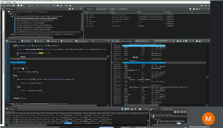

Hi TI team!
We observed an issue in Flash_norQspiWaitReady function where very long timeout or issue with reading, which could sometimes lead to system freezing.
        if((readStatus & devCfg->srWip) == 0)
            break;
this read status returns 35 from SPI_DATA_REG
SDK version mcu_plus_sdk_am263x_08_05_00_24
Could you please help us how to fix this issue.
Regards!
  • Hi Oleg,
    Looks like your flash part has hung. You are not able to read back anything from the flash before/after you issue the erase command.
    Aakash
