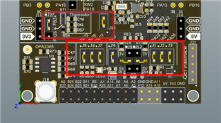

    However, we can let customer to do evaluation them based on our LaunchPad, which intergrated in a energytrace IP to detect the on-board current consumption. User can active the peripheral and then get the data.
    Below is the user guide of XDS110 which have the energytrace function: (also included in the LaunchPad)
    https://www.ti.com.cn/cn/lit/ug/sprui94/sprui94.pdf?ts=1708938033988
    Note: customer should remove the bottom jumper on the LaunchPad to remove external current consumption.
