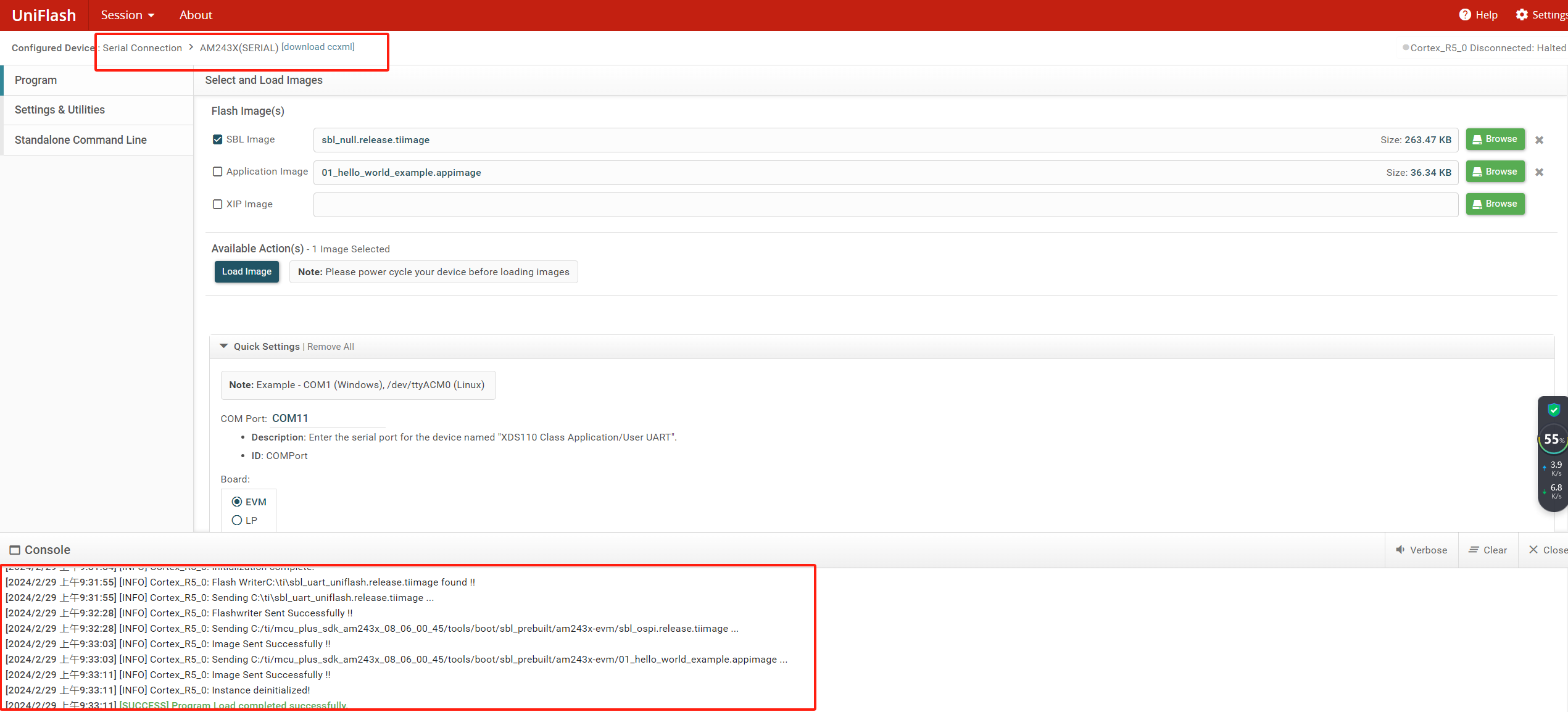

  • Hi Karan
    I used UniFlash_8.6.0 and was able to write "sbl.tiimage" and ".appimage" files to Flash. However, on the AM2434-EVM, it seems that the tool could not write files to the eMMC. Unfortunately, I also did not find a way to format the eMMC memory.
    Can you explain the steps to format the eMMC in detail? Thank you very much.
    Weijian

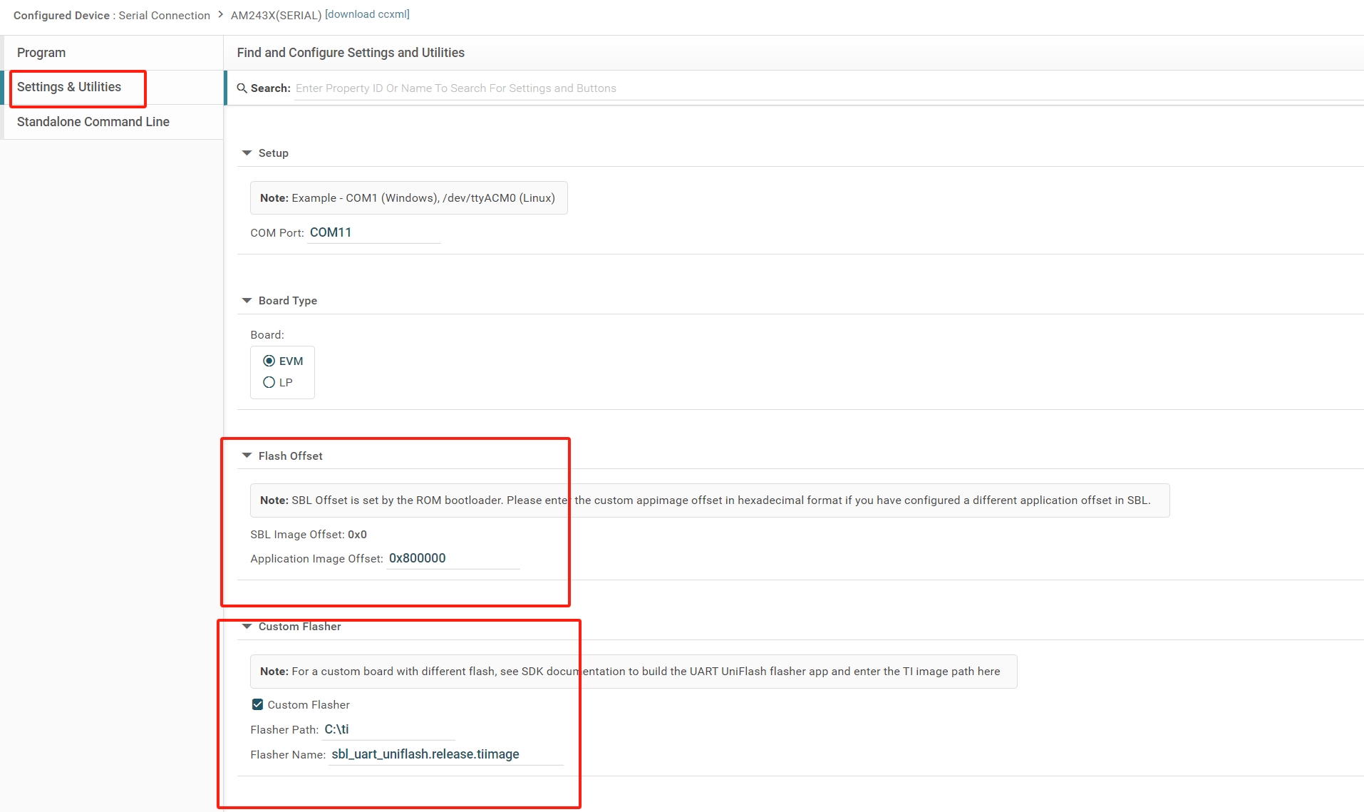

  • Hi Karan
    Following the method you suggested, I would encounter the following error.
    Weijian
  • Hi Karan
    My board is non hsfs board (AM2434_EVMTMDS243GPEVM) .
    I tried many times, but still got the error message. What can I do to solve this problem?
    Weijian

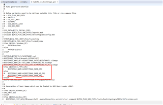

  • Hi Karan,
    I made the following changes:
    (1) I select the "sbl_uart_uniflash.release.tiimage" file from MCU_SDK_AM243X_08_06_00_45.
    (2) I modify "makefile_ccs_bootimage_gen" in sbl_emmc_example(mcu_sdk_09_01) to generate the".tiimage" file.
    Prashant
  • Hi Weijian,
    I see.
    Even if you can generate GP image with that hack and let's say the flashing is successful, the flashed SBL_EMMC simply won't boot. The GP images require GP SysFw binary but there is no GP SysFw binary in MCU+ SDK v9.1.
