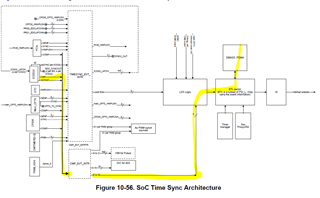

  • Hello Bastian,
    Our actual concept (non TI) is to trigger TX and RX every x us.
    The proper method is that DMA should be initiated automatically when a timer event is generated.
    I never tried this method with the UART + PKTDMA and I have used this method for BCDMA memory copy operations.
    I am proposing the same method here.
    If you want to transfer data at a particular X sec or receive data at X sec, this should be through Timer + UART + UDMA driver.
    You have to follow the below steps
    Step 1 :
    Create Timer interrupt for your X use
    Step2 :
    In the above routine, you can call TX UART+UDMA API to initiate the DMA
    Step3 :
    Once it's finished, the above steps trigger new data.
    In UART+, UDMA the driver will use the Udma_ringQueueRaw function which initiates the DMA transfer. If you don't call this function, then DMA will not initiate the DMA transfer. In most cases, we never changed the TX count size. In that case, you can configure all parameters initiation for one time next just call the Udma_ringQueueRaw API to initiate the DMA.
    During RX it is possible that a subsystem does response either with 4bytes, or 4bytes + defined number of bytes.
    Can you please check with the API below
    Udma_getPeerData by using this API, getting received bytes and not full data bytes, which is implemented in the MCSPI driver and, the try to do the same in the UART driver.
    Typically in UDMA if the total no of bytes received then only user should able see the data .
    S.Anil.
