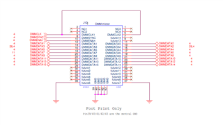

Could you provide the pinout/signals for J12 (19x2, mictor) DMM functionality? I'm wanting to know if and where the TMS5703137's pin J16 (DMM_SYNC) is routed.

Here is the pinout for J12:

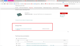

And you can access the complete schematic from below Link:
TMDS570LS31HDK Development kit | TI.com
