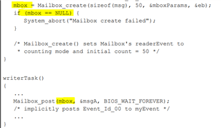

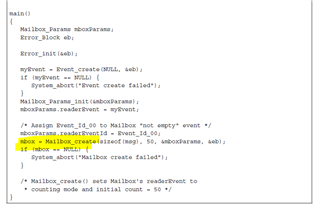

Hi Charles,
Is there any way to check if the handle is valid before sending a Mailbox_post message? I was hoping that this would have been built-in with the command returning an error, but it will cause a memory exception instead.
I know it is a rare case and you have workarounds such as semaphores, but as it would be useful for one case, at least I wanted to try in case you have a good idea as I did not find anything useful.
Thank you and regards
