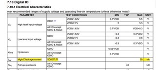

Team,
is the leakage current specified in the datasheet (see below) really over the entire ambient temperature?
My customer cannot believe how good it is and wanted to confirm Slight smile
I guess this value needs to be considered as +/- current, so can be sourced and sinked?
