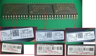

Please help to confirm whether the silk-screen fonts of the same batch of products are different, and whether it is normal, thanks a lot.

Please can you confirm where these were sourced from? Through TI or authorized distributor? Can you please let us know, thanks.

lei,
Please can you let us know where you purchased them from? TI or Authorized source? If authorized source, which one?

Hi Lei,
We can only comment on material that is confirmed to have been purchased directly from TI or authorized distributors. However, for this product, there has been no report of manufacturing or customer issues.

Hello Lei,
There may be slight variation due to using different Laser marking machines in manufacturing. Please provide an image of the label on the reel.

Hello Lei,
The marking seen on these units are acceptable and are due to process and machine variation.
