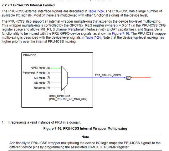

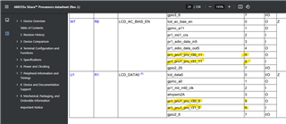

I have a question about routing the eGPI and eGPO to the device-level pins. According to the Datasheet, the PR0_PRUn_GPIO mode can be configured for a pin at a device level, however I couldn't find  any information about configuring that pin to be an input (connected to eGPI and read from R31) or an output (connected to eGPO and modified through R30). For example, both eGPI0 and eGPO0 from PRU0 are muxed to PR0_PRU0_GPIO0 on Pin K17. What register contains the mux setting?
Pouya
  • Hello Pouya,
    When the device pin is mapped to PRm_PRUn_GPIOx at the system-level, and mapped to GPIO (Mode 0) at the PRU-ICSS level, it will operate as either eGPI (when reading from R31) or eGPO (when writing to R30). There are no additional registers to be configured.

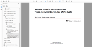

  • Hi
    The input or output configuration for a PRU GPIO is controlled using ICSSM_PURx_GPIO_OUT_CTRL register. Please see section "6.1.7.6 ICSSM Global Configuration" in AM263x Technical Reference Manual for more details.
    With this, only pins which are configured for output will be controlled using R30.
    Dhaval
  • Hi Dhaval,
    There is no section 6.1.7.6 in the latest AM263X TRM (Rev E). I searched for the register name in AM263x Register Addendum (Rev D) document, but couldn't find the register.
    Pouya
  • Hi
    Sorry, I was referring to an older version of document.
    You can check section 6.1.3.2.5 ICSSM Global Configuration in the latest revision (Rev E).
    You can check sections 2.3.91 CFG0_PRU-ICSS_PRU0_GPIO_OUT_CTRL Registers and 2.3.92 CFG0_PRU-ICSS_PRU1_GPIO_OUT_CTRL Registers in Register Addendum.
    Dhaval
