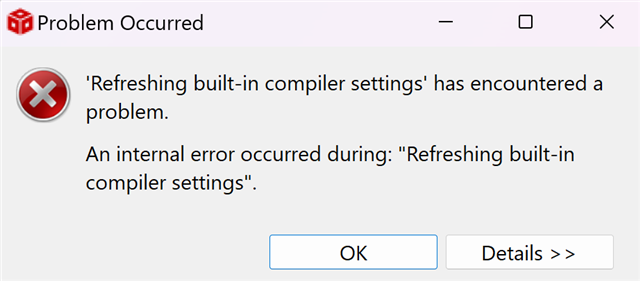

Hi, I have been happily working with CCS12.5 for weeks. Today I probably was trying to do so many things at the same time and now I am getting for a specific project.
Let me list all what I have already done without luck, always getting the same error
- I deleted the project from workspace and re-imported.
- Imported in a new workspace
- Delete project from my sdk and copy again from an untouch sdk
- run ccs with "-clean" option.. it hangs
I haven't re-install CCS, but if there is any other way to get rid of this issue I would appreciate some tips/ideas.
As a note, other projects are building OK, it is just one that somehow got messup
thanks for your help,
Paula
  • Well re-installing SDK seems to work. Now I can rebuild previous problematic issue. However, wondering why deleting the project folder (from SDK) and copy a clean one (from another SDK location) didn't work and I have to completely reinstall SDK.
    In any case, I am unblocked.
