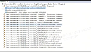

The python script is successful, however the sbl stuck atSciclient_waitForBootNotfication() when they power-on the board (custom board) again.
Following are the spot where they stuck and the serial outputs:

Hang.
  • Hi Hang,
    I see some inconsistency in the issue. This is because if the SBL is really stuck in `Sciclient_waitForBootNotfication()` then there will be no logs at all on the UART console since the function call `Sciclient_waitForBootNotfication()` is at the very start of the main function before any logs statements.

  • Hi Prashant,
    Sorry for the confusion I've caused.  The UART console is the latest status, customer has passed Sciclient_waitForBootNotfication().

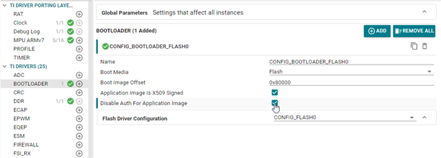

    So, the issue is about the "Some tests have failed!!" error. Can you please ask the customer if this error is coming on each POR or randomly?
    Additionally, can you also ask the customer to check the "Disable Auth For Application Image" option in the Sysconfig of SBL OSPI as shown below and see if that boots the application correctly.
    Prashant
  • Hi Prashant,
    Checking this option solved the problem, many thanks?
    Additionally, Customer would like to know what exactly is disabled here. Can they do something to the image so that the Auth can success?
    Hang.
  • Hi Hang,
    Checking that option disables the Authentication of the appimage. If this option is checked, the SBL at runtime does not request for authentication of the appimage and directly boots it.
    Since, the error "Some tests have failed!!" goes away on checking that option, it means the error was due to the Authentication failure.
    The customer can continue the development with the authentication of the appimage disabled, it is however not recommeded to disable the authentication in production stage. In production, we would ideally want to first authenticate the appimage to make sure the appimage is legit & can be trusted before booting it. This is the primary purpose of using HS devices.

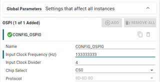

  • Hi Hang,
    That makes sense. Can you please ask the customer to run the OSPI at lower frequency 133333333 instead of the default 166666666 in SBL OSPI Sysconfig like shown below and see if that resolves the issue.
