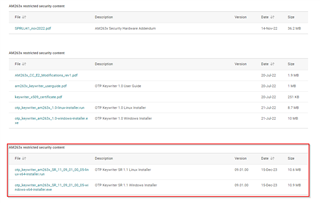

They are developing HSM firmware solution, and found that after changing to new version device with ROM version and HSM ROM version updated, the OTP key writer failed to program the key. The following is the log info of ROM version and HSM ROM version:
They are using TIFS_08_05_00_07.
Please check if they need to use new version TIFS as well. Thanks.
