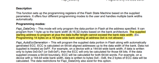

  • Hi Vidya,
    I understood the root cause of the issue.
    Please refer the below highlighted lines from F021 Flash API manual:
    *F021 Flash API Reference Guide (v2.01.00) (Rev. H) (ti.com)
    Here what they are saying is that the starting address plus number of bytes we are trying to write should not exceed the bank data width.
    For TMS570LS1224 device also have 16 bytes of bank data width:
    As you can see the programming width it is 144bits, in this 128bits are data and 16 bits are ECC. So, the bank data width will be of 16 bytes (128/8).
    So that means the possible data writing will be as below:
    after this data didnt get flashed from 0x20ffd - 0x21000(4 bytes)
    Address 0x20FFD can be written as (16*8447+0xD) which is equal to the 16*N+D in our table.
    As you can see above table, if our address is 16*N+D means then the maximum possible data bytes can only be 3 bytes we can't program four bytes here.
    from 0x21001 - 0x2100C(12 bytes), data got successfully flashed. again 4 bytes remained as FF and 12 bytes got successfully flashed and this pattern is repeated.
    Here also same thing the address 0x2100D will be (16*8448+0xD) which is equal to the 16*N+D in our table. And in this case also the maximum possible data bytes will only 3.
    Thanks & regards,
    Jagadish.
