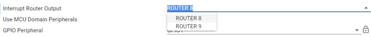

We noticed the GPIO interrupt router number that is allowed to be configured in syscfg is different from each SDK/syscfg version.
For gpio_input_interrupt_am243x_evm example, we noticed that different SDK/syscfg versions have different GPIO interrupt router number range.
This caused issues with updating our project from SDK 08.05 to SDK 09.00. I see the same issue will occur when we update to SDK 09.01.
Could TI please help to understand why the Interrupt Router Output range are different between different SDK/syscfg versions?
For SDK 08.05 with syscfg 1.14,
For SDK 09.00 with syscfg 1.17,
For SDK 09.01 with syscfg 1.18,

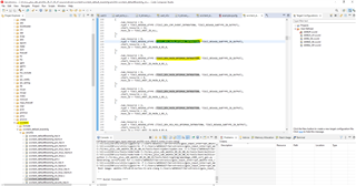

    Please look at the image below. MAIN_GPIO_MUX_INTR Router has 16 Router outputs which are connected to different cores.
    The Router outputs are purely configured based on the customer's use cases.
    For example, one customer wants to route 4 GPIO interrupt Router outputs to R5F0_0 but in MCU+SDK we have routed only two outputs. In this case this file should be, updated based on the user requirement.
    This resource allocation will change based on different customers use cases to set proper resources allocation for all cores.
    This file is purely configured based on user requirements. If you need only two router outputs to R5F0_0, then update the below  file and compile it and load the SBL with updated board cfg.
    Typically, these resource allocation can be done in the file below please look at them.

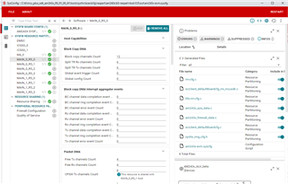

  • Hello Michael/Hong,
    I tried following the instructions for 9.01 SDK on AM243x and the base file opens with multiple errors.
    Can you please share what errors you are facing ?

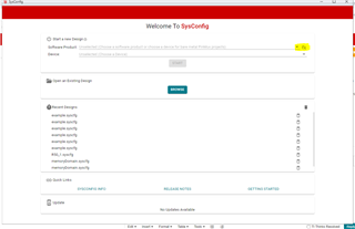

    I have followed the below steps to open board cfg files .

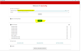

    First step we need to give a path for the Resource partition tool and next open existing board cfg file from below path.
    The Resource Partition Tool path needs to be given in the system config : \ti\mcu_plus_sdk_am243x_09_01_00_41\tools\sysfw\boardcfg\respart
    Next, open existing Board cfg file
    Path : \ti\mcu_plus_sdk_am243x_09_01_00_41\tools\sysfw\boardcfg\respart\am243x\k3-respart-tool-0.5\out

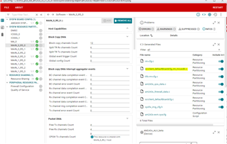

    After that, you can play with resources allocation.

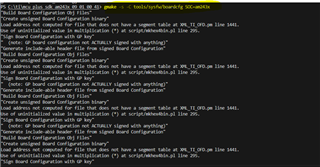

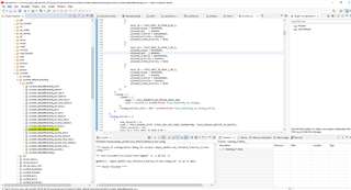

    Next, copy the file highlighted file in your workspace and change the file name to. sciclient_defaultBoardcfg_rm.c file
    Compile sciclient_defaultBoardcfg_rm.c file by using the below command.
    Next, we need to compile SBL for a new board configuration.
    After that, flash the updated SBL on SOC. So, that your updated board cfg is available on SOC .
    Please let me know if you face any issues.
    S.Anil.
  • Hi Swargam,
    thank you for the guidance. I was using the version of the k3 partitioning tool provided in the FAQ post (https://e2e.ti.com/support/processors-group/processors/f/processors-forum/1308689/faq-how-to-use-k3-resource-partitioning-tool-with-processor-sdk-v9-0-or-v9-1)
    When I switched to the version provided in the SDK under c:\ti\mcu_plus_sdk_am243x_09_01_00_41\tools\sysfw\boardcfg\respart\am243x\k3-respart-tool-0.5\ the board file CFG file opened with no errors. We will let you know should further questions arise.
