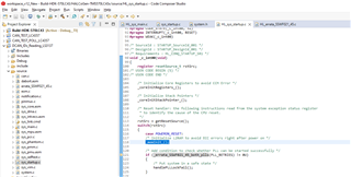

    If this bit was not set, then all the peripherals will be in reset state only. That means even though we write value into the peripheral registers that won't get write, only after setting this bit then only all the peripherals will come out of reset and can take the values.
    So, this bit should need to be set as soon as after device RESET.
    It would be better to set this bit after memory initializations done. Because after this PLL, pin mux initializations etc will come right.
