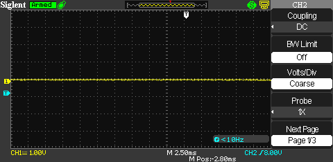

  • I am not particularly familiar with nortos applications, so forgive me if I configure the example incorrectly. I've attached my code, a screenshot of my oscilloscope monitoring PK3, and the UART output I'm receiving from the LaunchPad.

  • On the below line, you need to change to ADC_CTL_CH19 which is PK3. Please also try it on other channels like PE3/PE2 or PK2/PK1 to get a good reference for comparison.
    /* Configure Sequencer 3 to sample a single analog channel : AIN0 */
    MAP_ADCSequenceStepConfigure(ADC0_BASE, 3, 0, ADC_CTL_CH19 | ADC_CTL_IE |
    ADC_CTL_END);
  • Thank you.
    I've tried AIN16-19, and they all appear to work properly in the nortos example. Their readings roughly match my oscilloscope. Do you know how I might fix this for the freeRTOS implementation?
