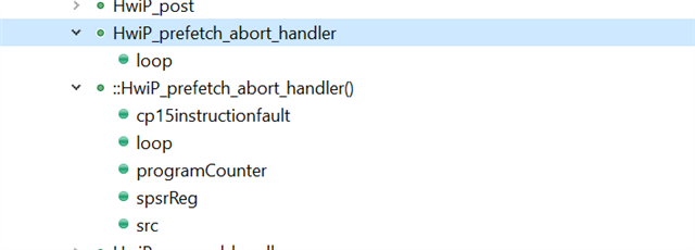

I am using CCS 12.5 I cannot tell why but somehow CCS won't find my source-file for a specific implementation. It does nevertheless for most other files but not for that specific one. The function in question is our implementation for HwiP_prefetch_abort_handler and other abort-handlers.
It will always show this:
I tried to set the direct path to the file in the Debug Configuration->Source-Tab but it just ignores it and tries to find a file from a jenkins-path which is not found anywhere in our compilation.
I also can indeed navigate to our correct file out of the modules view:
But I cannot add breakpoints there and if it searches for the functions directly it will show them two times, one with the sdk-implementation (which is overwritten by ours, declared weak) and one of us:
Also the dissassembly shows our implementation and not the SDK-one. So it compiled correctly. But if I click on any of them a file-search-dialogue opens.

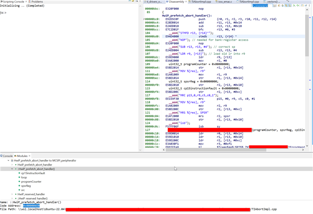

  • Thanks Tushar,
    I'd like to give you some more information I found:
    So for the non-working-target it shows the path correct at least, in the modules view:
    we can also clearly see in the disassembly that the compilation has our compiled code in it:
    and now the working one, with the same code-base looks like this:
    the path is nearly the same except of a different base-path but it uses the same git-submodules, same build-process etc.
    I think the only difference we have a is a little-endian compiler-option but that's all. Of course the linker-script is arranged a bit different. What I missed to say: we use the tiarmclang LTS 3.2.0 compiler
    I intentionally used the same debug-configuration in CCS for both, so it doesn't seem to be relied on this. And please keep in mind this seems to be the only location where this problem occurs. I tried to find functions of the SDK, as well as other of our functions of source files in the same folder. They all work. Ok, not all, some somehow open an cslr-file, but at least I can navigate to the functions and the symbols resolve and I can set breakpoints there.

    If you use the "Locate File" button to explicitly browse to the correct file, does it work after that? Does it find the right file and you can set source line breakpoints correctly?
    You also mentioned a working and non-working environment. They are loading the same executable and with access to the same source repository? What is the host OS for both? Looks like you are also using Windows Subsystem for Linux and that is where the source is. I assume you are using it for builds. Are you using CCS projects or a custom make environment (or both)?

  • Hey Ki,
    yes I tried it, shortly the file pops up but immediately returns to the mentioned view.
    It is not completely the same executable but a large part of the source-code is exactly the same, since it's our platform, which is included via a git submodule. So it's ensured they use the same commit for our "hw-support-package" which also contains the same MCU PLUS SDK. only the "project"-part is different.
    And Yes we use wsl as an environment. To ensure compaitibilty we use th debug-prefix option:
    "-fdebug-prefix-map=${CMAKE_CURRENT_SOURCE_DIR}=${WINDOWS_CURRENT_WORKING_DIR}" in CMake that way and add it as compile-option later on.
    We are using a cutom make-environment for this, yes. It's CMake. The sdk is built via a separate command which just calls make. The CMake-projects just uses the built libraries of the SDK.
    The abort-handlers would be present there, but declared as weak and later on will be overwritten by our handlers. This works as wen can see in the compiled image and the disassembly. And for the working one it also shows the related .cpp-file correctly.

  • yes I tried it, shortly the file pops up but immediately returns to the mentioned view.
    I assume it opens that one time and then when you step or do some other target execution, it loses the source association.
    I'll need some kind of test case to investigate further. I know this may be difficult to provide but I'm not sure how best further to proceed in debugging this issue. Ideally it is some stripped down version that is very simple. Almost some dummy program that uses your custom implementation for HwiP_prefetch_abort_handler. I would need the executable that was built and the source. Of course you can share via E2E private message if that is preferred.
    ki
  • Hey Ki,
    I provided a link via an e2e-message. I also noticed that somehow the weak-declared abort-handler as well as our own implementation is compiled into the binary but only our implementation is called. We did compile everything with -ffunction-sections and -fdata-sections and it works for all the other stuff. Since this affects both binaries and one at least resolves the symbols correctly I guess that's not the main issue but may be another issue as well.
